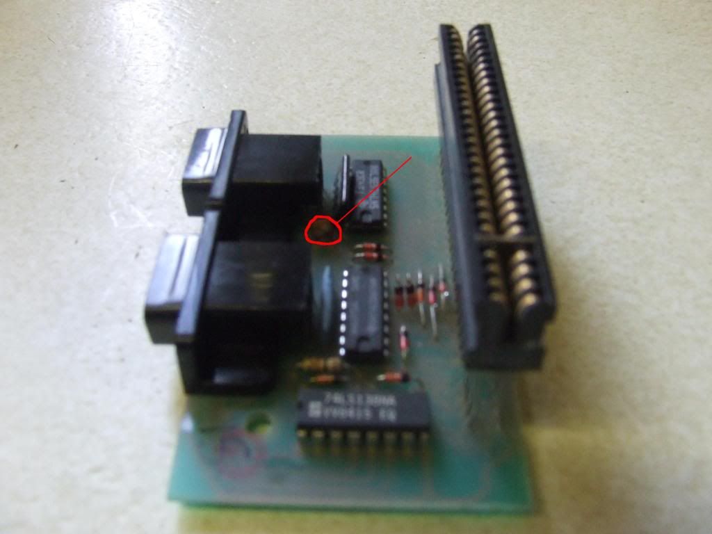

    I looked inside the D'Ktronics interface. Now I am no electronics expert, but I think I spotted something unusual. There was a yellowish/orange component which stands on two legs and is vaguely oblong (although I have seen round ones before). Anyway, on both sides it has a whitish powder appearing to be stuck to it, looks like it may have leaked out. I don't know if this could affect anything, or if it is just historic dirt, but I thought I'd mention it just in case. I can't really think what could go wrong with a joystick interface to be honest, but I suppose something could.

    take a pic of the dk tronics thing

    I am off to photobucket now so that I can upload a picture of the 2 port D'K tronics interface.

    Thought about posting them seperately, but best just tolet people click the link?
  • edited August 2010
    It is not clear from those photos which component you are talking of - could you highlight it on the picture (a circle or something)

    rwap wrote: »
    Please see below:
    I have ringed it, but it isn't very clear. Maybe if you look at the original picture, now you know the component in question, it is clearer. I think the red makes it harder to see.
