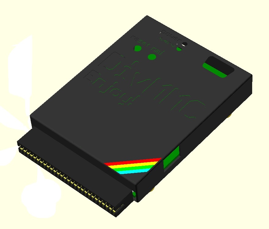

    Design of the case is almost done!!
    I'm very excited!

    First final design is ready!
    Ordering the first SLS printed cases today!
