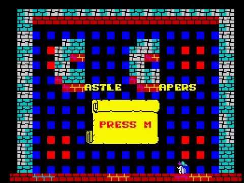

CASTLE CAPERS
The Dream Fairies have been kidnapped by the evil mouse king and his horrible accolites
Use your magic to make blocks or holes and go up and down the platforms to rescue the fairies (number increases with levels)
Infinite lives but avoid the mouse king or he will eat you up
(he will eat the fairies and you will loose the game a well)
OPM to play
1 restart level
2 abort game
