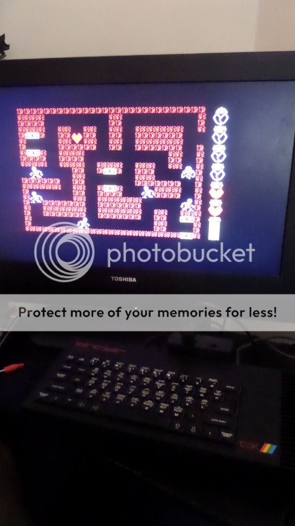

Played on a real Speccy - 128k .... Love this sort of game (enjoyed Cybermania too)... Great fun. Well made... loved the skele-sprites. I did pretty well on my first go - Got the key and nearly made it to the door.... Don't know how long it is after that ? anyway - liking it.
