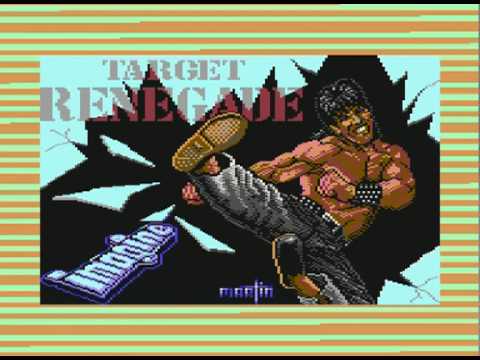

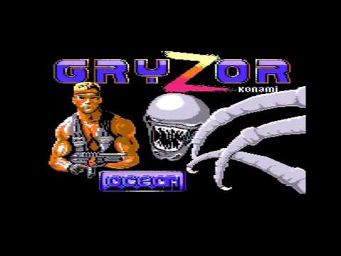

    Copies of the original SID files that your YouTube videos referrence (the ocean loaders).
    Examples of the tunes rendered via the standard 128k AY chip (Gryzor.Tap & Target.Tap), for standard 128k setups...
