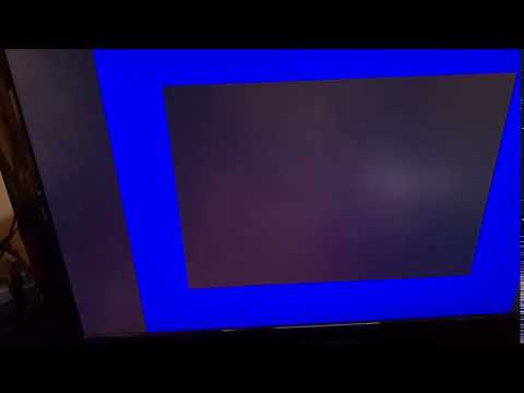

Ok, we have somehow "hacked" ESXDOS and we found a way to make autostart work for all versions of ESXDOS.
You can see it working here:
Here, there is a longer and technical explanation:
