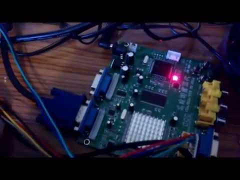

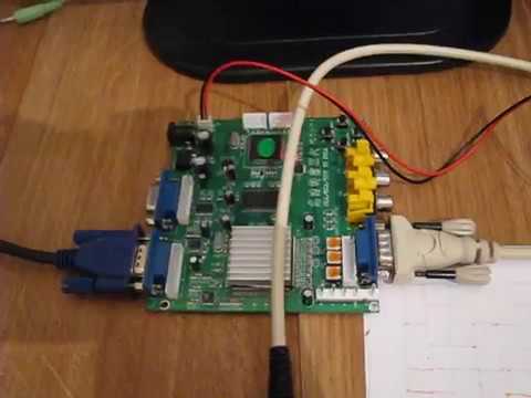

  • Answered my own question... Also found a few for around GBP17 each on Amazon, which seemed really cheap.
    Links to them in case anyone else was using them ( though these are old, so maybe it's already common knowledge ).
    - Someone using to run a 128+2 to a VGA monitor.
    https://cygnus.speccy.cz/popis_propojeni_zxs128kplus2_a_gbs8220.php - All the wiring information.
    - Connected to a 128+3
