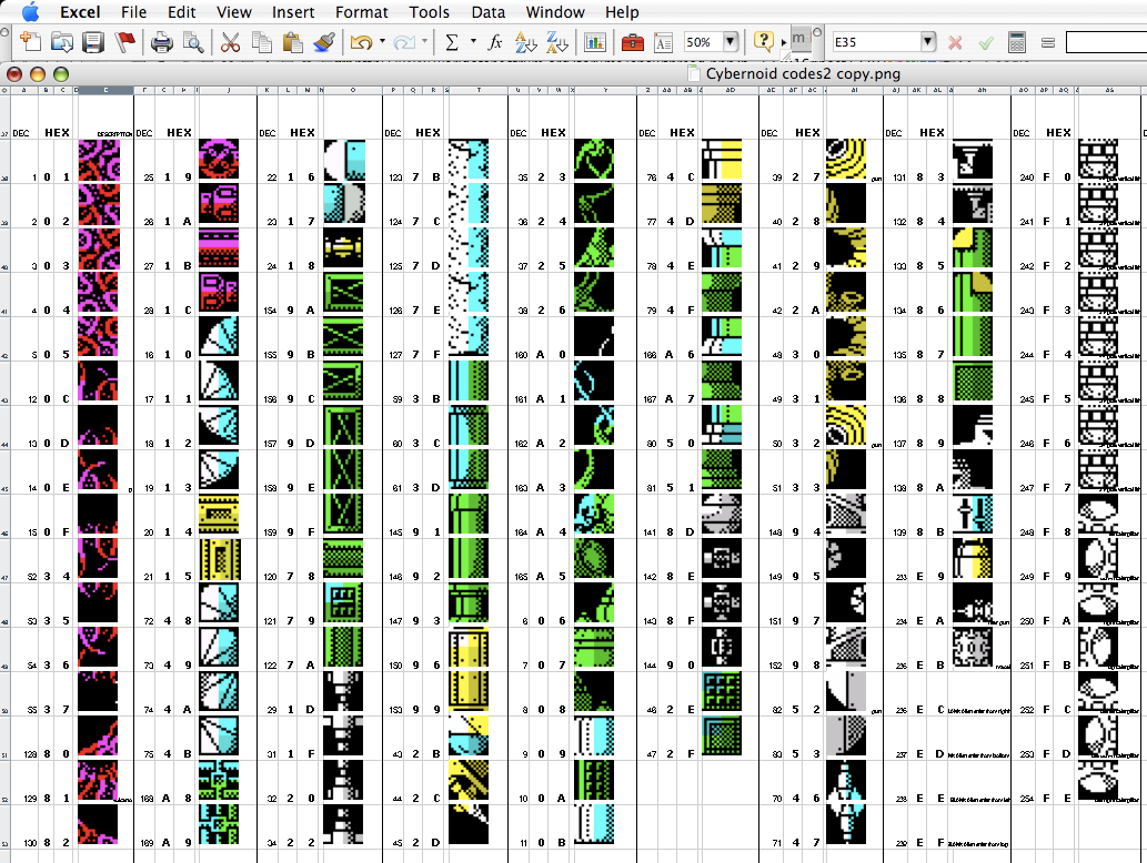

I need to create appropriate graphics to represent the special codes E9 to FE anyway.

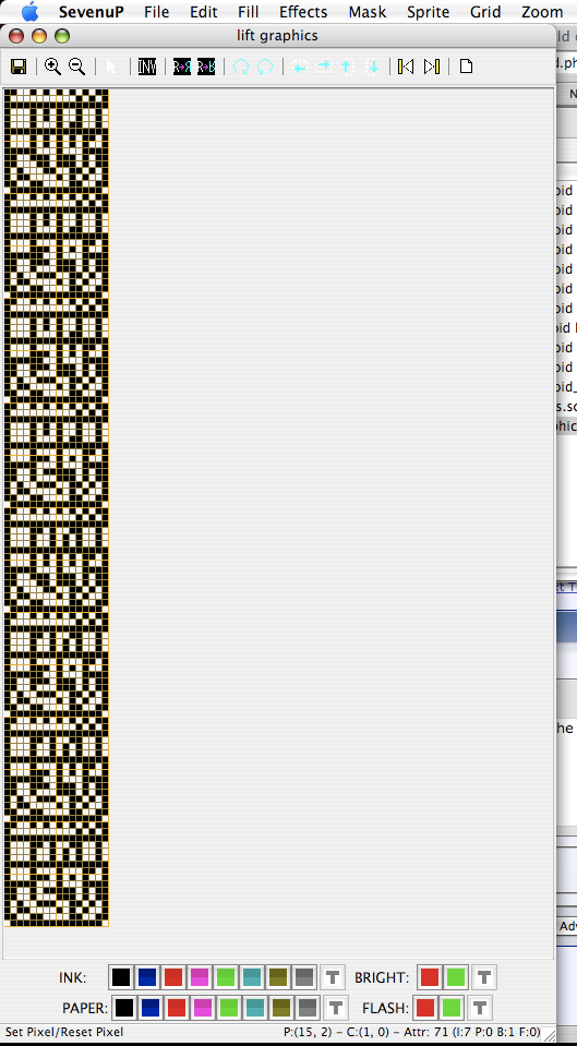

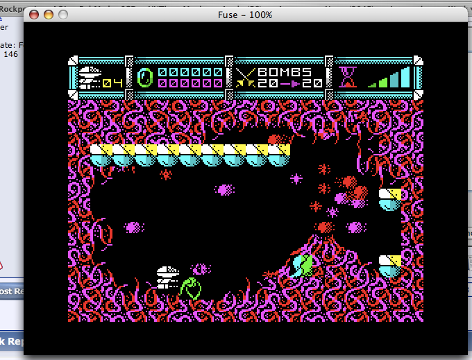

I`ve made a pic of the 4 gaps of up/down enemies exactly as they appear in game, each gap is 5 pixels less than the previous, which may be a problem. Also important is the top one is the one that is positioned on the screen. Pics are double sized. F0-F3 (3E-45) F4-F7 (3E-45)
I made the arrows myself, here they are

thanks for the lift graphics, unfortunately, I cannot think of an easy way to incorporate them. Last night, I too, made some new lift graphics: see below. Drawing the full lifts will be problematic in BASIC, so I am thinking of just these graphics to display the upper lift.
I could draw new lift graphics that are shifted, so 2 tiles for each lift in its shifted position. Then when you place the top lift, your program could draw the lower one with a gap of 2 tiles below it for the 3 largest gaps, gap of 1 for the smallest gap. It will need 8 tiles for all 4 lift sizes though.

Below is my proposed reorganisation of the tiles. I have tried to group related things together. Comments are very welcome.
The gun turret (#52, #53), should be next to #50, #51 as the turrets are drawn in the original game. Everything else looks good. I thought of a good graphic for #EC to #EF, a little space invader and a big arrow for the direction they enter the screen, it doesn`t matter where these are placed in the screen.
Graphics for EC-EF; EC, ED, EE, EF EC-EF source Cybernoid format.

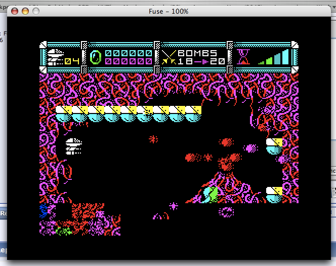

I`ve tried this, the lifts don`t collide with anything on the inside edges, collision detection is only on the outside edges.
What a swiz. I'd thought up some interesting uses. Do they collide when their outside edge hits the block? e.g. do they overdraw a tile completely and then bounce back?
Edit: I see that they do not do that either :-(

Superb, you`ve managed to get collision detection between lifts as well as a tile being removed from the map, these hacks will really enhance the gameplay and variety.

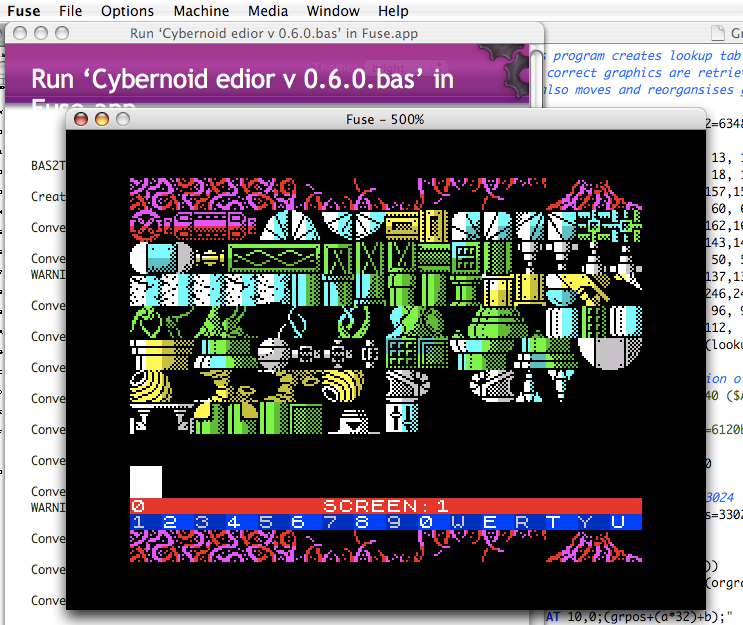

OK, tonight I've been beavering away on the editor, which has made it to version 0.6.
The big change (and challenge) was reorganising the tile graphics data into the order I proposed a day or two ago. This also required creating appropriate lookup tables so that correct codes get inserted into the screen data areas during editing, and so that correct graphics tiles get drawn during screen display.
After much fiddling, I'm happy to report that it all seems to work fine :) The downside is that redisplaying a previously edited screen is now 160 PEEKs slower than it was before (due to having to reference the lookup table once per tile). But on balance, I think the more structured organisation during editing is worth it.
It does not yet include the newly drawn graphics for the special codes. I'll put those in as the next job. Then I just need to finish up the compressor, implement a screen moving tool in the map editor, and write some basic input stuff for level/ship specific data and we are done!
Here is a screen capture of version 0.6 showing the tiles in the new order.
The downside is that redisplaying a previously edited screen is now 160 PEEKs slower than it was before.

Look at: before and after I shot the plant at the bottom. This effect is carried over into subsequent screens too.

http://i22.photobucket.com/albums/b339/ETamm/Cybernoid%20Editor/Liftnew.png

Lift graphics asm
Proposed new codes layout
