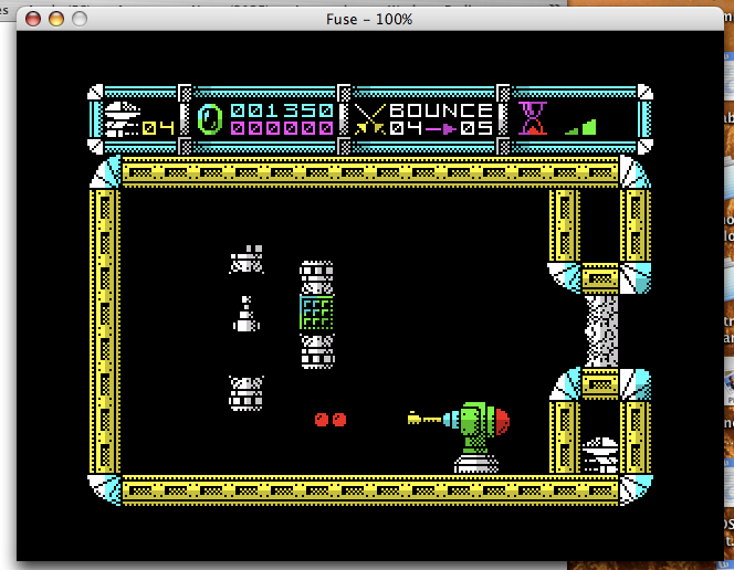

Gun Demo Test
This is just a snapshot of a test screen showing off my new explodable gun.
The tiles are positioned like this for a non firing gun that explodes, for a firing gun change the #69 to #94;
69 6A 6B
....6C 6D
Can you recognise the gun?

Here is another little test screen showing my new girders and platforms, also the gun turret can now be disabled by shooting it. I`m getting a little dot of corruption I have to look into, drop left of the platform and edge upto the bottom of the girder to your right. The colours need a little work, as its too samey.
Hi Frank. I like the look of the new graphics. Using the girders in this way is cunning - it helpfully increases the screen area in which you can navigate - yet still restricts you from flying out of the room.
I have a question: When you design the new graphics, what determines whether the Cybernoid ship collides with it or not? Does a movement routine just check for the attribute colour - e.g. It looks for 00 in a particular quadrant of the tile, and if so, allows the ship to continue moving?
Also, did you intend to put explodable block under the pillars in this room? Try using Seeker. (You get some more corruption from this too.)
69 6A 6B
....6C 6D

Seriously - this is great work Frank, the Exolon gun looks cool!
