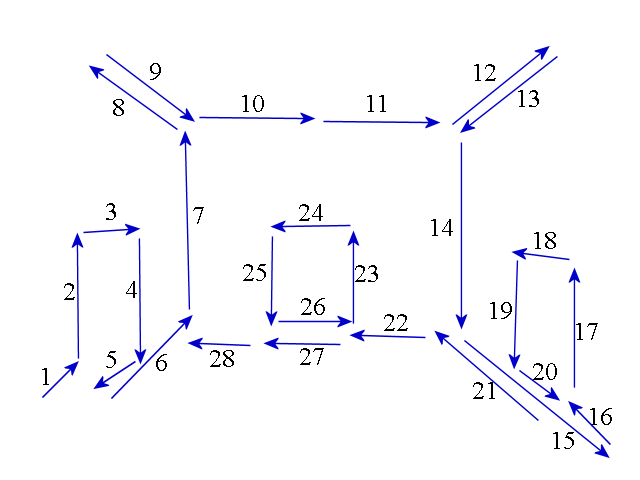

However, the perspective is still wrong. The 6 "diagonal" lines are unaligned, i.e. not using the same vanishing point. Check the explanation for "one-point perspective" at http://en.wikipedia.org/wiki/Perspective_(graphical) if you don't know what I mean.
I agree with all of your points, in particular that the perspective is still wrong, and that the door in front of the player is indeed a little too wide. I will fix the graphics in the next version.
I now remember about the concept of vanishing point from school, but I will read the Wikipedia page, because I have not applied this since I left school. I must have forgot about it again. It will be interesting to read up on this again!

The latter version seems 4 positions shorter, but this saving actually comes from removing the color difference between "rooms" and "passages" (which is important for game "ChamberMaze"). Adding back this kind of distinction would take more than 4 positions, which is the reason I abandoned this idea. Unless there's anything else I'm missing?
OK!
BTW I see no problem about a wide door, as long as the side doors are adjusted to look like they have the same size...

I have joined the routine to draw a frontwall with the drawingroutine for the sidewalls. This saved 3 bytes, but due to the altered code I could replace the exit-condition and skip another 11 bytes.
My latest version was therefore 38 bytes under max.
I always thought it was not worth it trying to "unify" the DRAW statements, but your latest version just proved otherwise. Great catch!!! :)
I checked your idea in further detail and realized it was possible to reduce it even more, saving another 33 positions from the latest version you posted. Here's a new version optimized directly from yours:

I have been doing some work on ChamberMaze this morning. Not actually on the game itself, but on a utility called "RoomTest", that I hope will allow us to finish the game with it looking exactly how we want it.
Sorry, it is very rough, it was only originally intended for my own use.
It displays the 28 lines used in drawing a room in ChamberMaze, in the order they are drawn.
Next, have a look at this program I made, called "RoomTest". It is not a oneliner, but it is a tool to generate the CODE strings needed to draw a ChamberMaze room, depending on user supplied parameters.
RUN this, and then just keep pressing ENTER to accept the default values.
Eventually a ChamberMaze room will be drawn, and then if 'g' is selected, the CODE strings for the room will be generated, for insertion into the ChamberMaze program.
This all works for the side walls and the far walls & door.

First look at this image
http://i77.photobucket.com/albums/j71/benkid77/speccy/roomtest.png
http://www.mediafire.com/?0dpyc9mnznm
