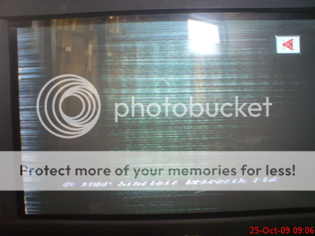

Hi. I have just bought a 48K rubber key version and am having trouble tuning it in. I have tried two newish CRT televisions but get the same picture.
I can just about see the Sinclair Research logo, but there are lots of white lines on the left hand side of the screen. I provide a picture here (excuse the bad quality):
Would the composite video mod be recommended?

    Welcome to WOS and: yes, I allways recommend the composite mod, even if the TV-picture has better "quality" than in your case.

    If it works with the composite mod (which is not a big deal, just solder a cinch cable on modulator input and ground, a capacitor as mentioned in the proper mod is a plus but not a must just for testing purpose) then you at least know the modulator causes the problems.
    If not, then the experts here can give you further advise.

    It worked! First time I have ever soldered something in my life! Great stuff.
    However, whenever anything in colour is on the screen it starts rolling. Has anyone seen this problem? Many thanks.

    The rolling screen issue isn't as frequent now. But when I set the screen to flash, or when it loads a game the screen jumps. If I stop loading or stop the flashing, the screen returns to normal. Cheers.

    You mention the composite mod has helped reduce the problem.
    Things to check:-
    We can now rule out RF tuning here as your going composite via phono cables to phono input on the television, so...
    I would put it down to RF interferance being picked from the modulator itself. Maybe try someway of screening the modulator from picking up internal noise that may effect the picture.
    After completing the composite mod, the second cause could be a cheap phono cable (make sure you use a well screened phono cable to connect the Spectrum to the television) to minimise interference).
  • edited October 2009
