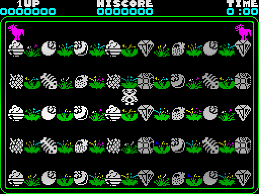

Here's a screenshot from the original game;

Here's a screenshot from Spectacular. As you can see I've been forced to reduce the playfied by a couple of rows because of the Spectrums lower resolution - and because I wanted to keep sprites/tiles at 16x16 so I could have full-color, but as you can see it has worked out just fine. ;)
Let me know what you think. ;)

    Arjun, this screenshot is from Spin and doesn't have the scanlines that the screenshot from Spectacular has, so you can see that there's just the colors that is possible on a Spectrum (it just looks nicer in Spectacular ;)).
    About colors:
    Up until yesterday I had the items that are thrown around keeping their colors, but I decided that it didn't look all that good when they flew around, so I've changed so that, when they're thrown, they're either white or colored by whatever item they pass through. It looks good and feels natural.
    For a while I wanted to make the koala bright cyan (which it still is on the screen above) but I've chosen to go with white in-game, and colorclash-wise there's no problem as other items dissappear when you walk over them.
    The dingoes are another matter. I haven't coded them yet, but I think I'll keep them magenta so they change the color of whatever they pass over, but I need to see how it looks first.

    There is a lot of color in the screen maybe even ... too much colour:-o I mean it's a bit of eye hurting (a feature of the original arcade too). How do you think people?
    Man, the player in that video is terrible. :lol:
    I'd be happy to consider changing items so they don't have colors, but personally I think it looks great the way it does now
    ...even if it IS going to be problematic once the dingoes start moving around.
    For reference, here a picture with all the fruits normal white and bright white (it's two screenshots stitched together). I think this is more eye hurting to be honest (especially the lefthand side using bright). Opinions?

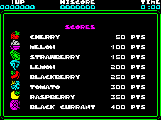

    Joe, here a screenhot of the "scores" screen with all the items on it.
    I'll detail where I've pinched them from, below. :)
    • Strawberry > from the Dingo arcade game
    • Pudding > from Atic Atac
    • Fish > Cookie
    • Diamond - Underwurlde
    • Tomato > Kosmos
    • Grapes > Kosmos
    • Yellow thingy > Kosmos
    • Magenta diamond thingy > Underwurlde
    ..so, like I said - all sto...borrowed. :lol:
    All the original sprites - except for the strawberry - ended up pretty bad when I tried to make them look better (in a hurry), so I gave up quickly and took what I needed from somewhere else so I could get on with the programming. I've kept the descriptions from the arcade game though...in case anyone is wondering. :D

    I don't have a screenshot of any of the deathscenes, but here's one from the game itself if anyone wants to see how it looks.
    ...man, I had to endure a lot of comments for having transformed the koala into a panda because suddenly "it didn't make sense that a panda eats fruit" so it stays a koala this time. :D

    Sokurah wrote: »
    Yes, most of my remakes are pretty close to the original ones as I think you have to be careful not to add or change so much that the game becomes something else. Sometimes it works though...but not always, so that's the route I'm going here.
    • Fish > Cookie
    • Tomato > Kosmos
    • Grapes > Kosmos
    Hi Sokurah,
    Looks great but just an FYI - the descriptions against the sprites seem to be wrong e.g. you have the strawberrry listed as a cherry and so on.
    Paddy
  • edited August 2011
    Oh, come on. I've already explained the the reason for that above...several times.

    Sokurah wrote: »
    Hi Sokurah,
    Sorry, came in to the thread late - did not mean to cause you pain. Just trying to be helpful.
    Paddy
