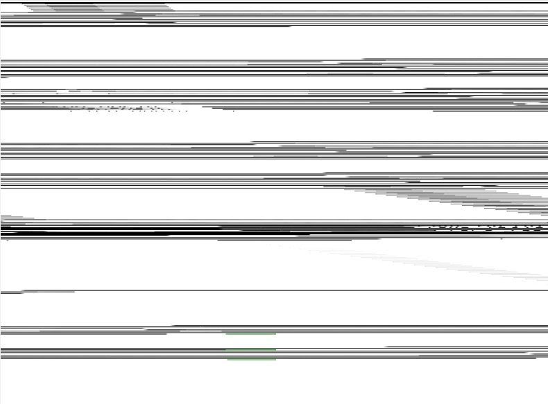

I've been trying to get my 128k toast rack to connect to my VGA screen for a while now with not much luck. I couldn't find a cable or adaptor to go from RGB to VGA, so thought I'd try a different approach.. I bought an RGB - Scart cable (which works going to TV) a TV tuner card, with RCA connectors, a SCART coupler and a SCART TO RCA cable. Set up the TV Card in my PC, installed all the software and drivers, then connected my PS2 to the RCA jacks and it worked, great, however when I try with the speccy, I get a very distorted picture, you can just about make out the sinclair copyright line, but it is not usable. I connected the RGB -SCART to a coupler, then connected the SCART to RCA into that coupler and then the RCA into the RCA Jacks.
Its driving me bonkers now! Can anyone suggest a way of achieving what I'm trying to do, preferably cheaply as I've spent a fair bit already trying to get this working! I don't mind plugging directly into the screen as I have a VGA switchbox, am also happy to use the TV Card and play from the TV Tuner software. (oh and I also tried going from the RF to the aerial socket on the TV card, with no success (guessing it needs a scandoubler or something?))

Does that work with a computer monitor, as one of my 'solutions' previously was a SCART to VGA cable, which of course didnt work as it was for HD TVS instead (didnt realise there was a difference)
I would love it to be that clear!! :) no, mine is worse, ....
Those lines are moving all the time too, give you a headache to look at!!
Yes it works for computer monitor, thats what it is designed for. VGA monitors can't in general sync low enough to display a RGB signal designed for displaying on TV's.
I have no idea why they keep this silly limitation now TVs and monitors are using identicle LCD panels.
