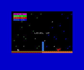

I've not managed to hit anything so I can only assume the game is bugged and therefore crap! Well done!

I don't think I'll post a hi-score challenge for this one..:o
I've managed twice, and apparently if you just miss your can press R which keeps the same angle and power but adjust your position.
Quite fun to play, and yes at least mildly crap. A nice backstory as this is a revamp of one of those neverplayed symphonies that got lost on a cassette decades ago.

This is tremendous fun!
