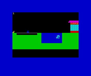

First entry in CGC OTTER COMPETITION!!!
Ottery Quest
By Steve McCrea
Otterly bad.
You forgot
ACTUAL SPECTRUM SCREENSHOT!!
Why didn't I think of that?? :lol:
