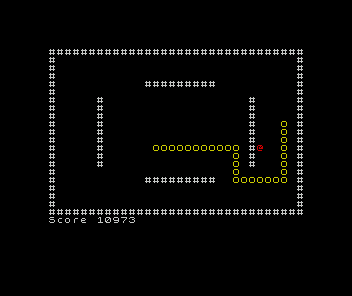

I originally used an array to store the x and y positions of the snake segments. This worked really well with a size 5 snake but by size 10 it slowed to a crawl. That's when I decided to store it in memory locations and use some simple machine code to copy the positions.
How hard could machine code be anyway? Well after several crashes (including spin itself crashing) and much swearing I managed to get something that actually worked!
No expense was spared on the graphics. The name was the hardest part. I was gonna call it Advanced Nokia Simulator but that wasn't puerile enough! And that ladies and gentlemen is how I played around with my snake until I was happy enough to share it with the public! :razz:
Aye I was surprised that it didn't slow down as the snake grew, still am actually as I thought drawing that many characters from BASIC would take up most of the time rather than the data. Good (!) work!
This plays really well! You fool! It makes me think of LumASCII, too. I have always wondered how these snake games work under the hood so I shall be examining this in earnest.
The snake only gets drawn in full at the start of the game. All that happens when you move is the head gets redrawn at it's new position and the tail erased. So the only thing slowing it down is copying the coordinates of the segments.
That's so simple, and obvious when you think about it! I don't have to bother looking now :)
You still have to implement a circular buffer though (since it is a double ended queue and you don't want to have to shift the array entries down a position every move). And there's no MOD (modulo arithmetic) in ZX Basic is there (and you can't do bitwise-ANDs either [since you would use a power of 2 sized array] or can you?). You have to do a tedious divide, subtract the integer part, and multiply up again to do modulo arithmetic.
Probably easier to do in machine code anyway (bitwise AND is your friend).
Some snake games are super-clever and draw different graphics for the head, tail and the 3 different possible turn directions as well. (ok, there are 4 different turn direction graphics but only 3 possibilities at each turn [straight on, clockwise, anticlockwise]). You can do that without traversing the entire buffer though.
But since when do snakes die when they run into themselves? And don't they have to shed their skin to get longer rather than just by eating "ampersats"?
EDIT: Sounds like Rebelstar IS copying all the segments down the array. LOL NOOB!
EDIT2: Easiest thing to do in basic is probably just use a counter (for start element, end element) which you manually wrap around when it overflows. Or do memory contents wrap when you poke them with values > 255? Cos you could do POKE(address, PEEK(address) + 1) to wrap around mod 256 and use a 256 length array in that case. EDIT3: I hope they wrap around. It would be retarded if you get an out of range error...
EDIT4: Moral of the story - the obvious way (use an array and copy the positions down each time you erase the first element) is probably the worst way to actually do the snake movement code [it's O(N) on the length of the snake (big-O algorithmic complexity) rather than the circular buffer O(1) case]. In a language as slow as ZX Basic you'd better pick a decent algorithm to start with.

Nah, I think it will be OK if I use a circular buffer (I guess I'll find out?). Only need to erase the element at the start of the array, increment the start, add the new head at end element, increment that, wrapping the numbers around. As long as start never passes the end (and by having a limited amount of food to eat per level, that can be guaranteed), LET bob = uncle. All I need is 2 arrays DIM r(256) : DIM c(256) for the row, column of each segment, and I can use the POKE trick to wrap a counter round mod 256 probably. May want to make the dimensions 255 instead since basic starts counting array indices at 1 instead of 0 :( I'd have to treat 0 as a special case then, probably better than adding 1 to the index everywhere though...
EDIT: Might just be easier to have a 32-length array and do something like
init: start = 1 : end = initial snake length + 1
set initial coordinates for snake segments in r, c arrays. end not yet filled in, that's where the new segment will be drawn
loop:
erase at r(start), c(start)
start = start + 1: if start = 33 then start = 1
keyboard stuff goes here, set new head position at r(end), c(end)
draw at r(end), c(end)
end = end + 1: if end = 33 then end = 1

aghh, using 2 arrays in basic will slow down the hole thing.
maybe use poking and peeking values in memory, its the same and ends up faster.
Yeah that would probably be best (but then, is it 100% BASIC??? UDGs don't count!), I take it arrays are really slow then? As I said in the edit I will only be touching 2 elements from each array each tick (I will be touching the end and the start of my snake as fast as possible). EDIT: I will erase 1 cell (if I didn't just eat any food) and draw 1 cell each tick, hence it is O(1) algorithm (independent of how large my snake is). EDIT2: And the only writing that gets done to the arrays is the new head row, column position. I read the start position to erase it in the loop as well.
EDIT2: Is it better to use a 2D array p(32, 2) rather than 2 arrays then? That's like using a struct! This could be a new programming paradigm! I'm guessing all the index offsets are worked out every array access so there would be no difference between p(32, 2) and p(2, 32) for speed (AoS [array of structs] vs. SoA [structure of arrays]). How big is the L1 and L2 cache on these ZX Spectrums anyway??? Does the JIT compiler for BASIC do any peephole optimisations and instruction reordering? ;)
I think you'll be fine with an array. Mine started out with an array and was quick enough to begin with. As you're not going to be copying large chunks of it you shouldn't lose any speed like I did.
They are slow, but only if you use the entire array, if you only work with one value each one at a time i guess it wont be a problem, and i agree that?s the best way to to do something like this.
But what do you mean 100% basic? poke and peek are also part of basic too :)

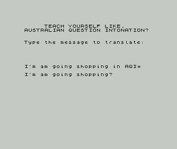

Teach yerself Australian.
By Lee Spoons.
Hope the French are next :D
Can anyone convert the WAV to a TZX or TAP? I failed with MakeTZX and can't get WAV2TZX to run.
Actually it's not such a non-standard loader after all (even though I saved it in SPIN) so I should be able to provide a TZX tonight.
Cheers, while we're waiting here's an alternative translating engine:
