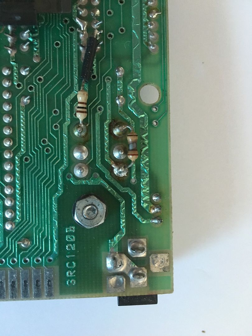

the resistor to the right is the one I am on about
will I do any harm leaving it or removing it
Also, it may now read 330 ohms, but it may have started as a lower value.
The whole point of the 7805 and the attached heatsink is to correctly produce nice smooth noise and ripple free DC +5V supply. Adding a resistor like someone has done, is not really helping one bit.

That exactly is my point "As far as I can see". You're still having to guess! Remove the burned resistor across the coil and that 100R one on the bottom too, then check again.

when I remove the resistors under the board I will check all the voltages again to make sure they are correct and see why the have fitted the 100r on the bottom and boron the top as the components should be
-5v - -4.97v
+5v - +4.49v
+12v - +12.11v
+9v - +10.53
not sure if the +9v is 10 high.
I agree with Death, investigate the low +5V line. A 7805 is rated at 1A, but a normal 48k Spectrum typically uses around 530mA to 620mA on the +9V input (with no expansions connected). Note that there is a slight variation in this current depending on the board issue / the exact chips fitted. For example:
